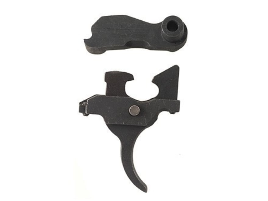

I also went ahead and dropped in the Red Star Arms/Power Custom hammer as I noticed a bit of marking on the rear of the bolt after putting a few rounds through it yesterday. Probably nothing, but, I'll err on the side of caution with this one.

Yep, that's the right one. I'm not entirely certain, but, I think the Red Star Arms and Power Customs hammer are the same. The instructions that come with the kit has both Red Star Arms and Power Custom listed on it.
