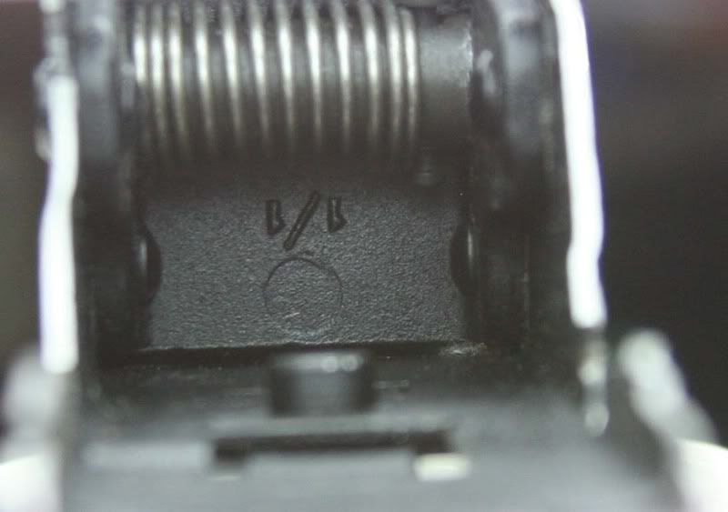

Here is a triangle folder with a ribbed butt and rolled strut edges that I bought from KVAR in June of this year. The mark looks like a large, sloppy, open-top "4" or a sideways "J". Is this Tula?
