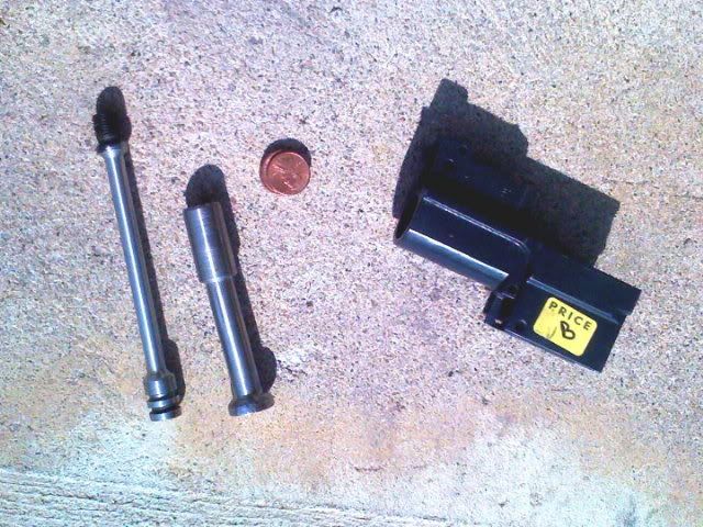

These are in with a very tight press fit. I use a 20 ton press and it pressures up quite high before it pops. Once it starts moving, it is probably only taking 10 tons. I made a short arbor to start the press, then move to progressively longer ones. The video is one of the first ones I pressed out.
http://www.youtube.com/watch?v=HOPtRYvqsHw
