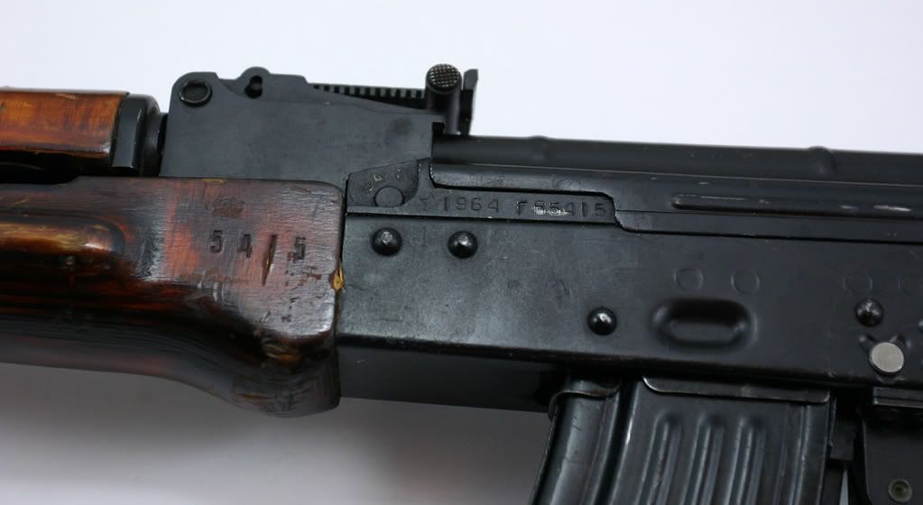

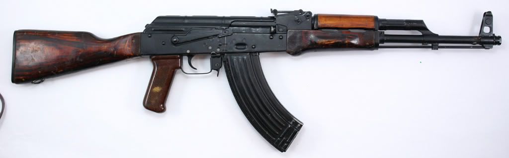

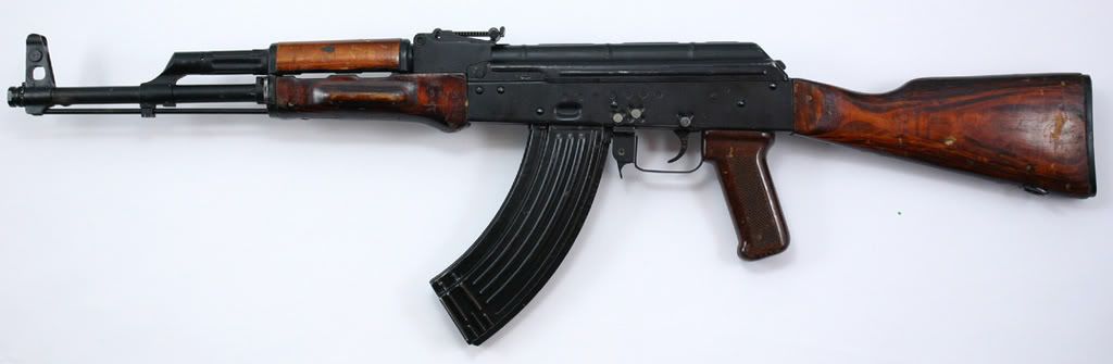

1964 Izhmash
All matching with original wood. The serial on the lower handguard matches, but is faded. Appears some sort of clear varnish was applied to the wood and has worn off. Basically the same as a 1963.
