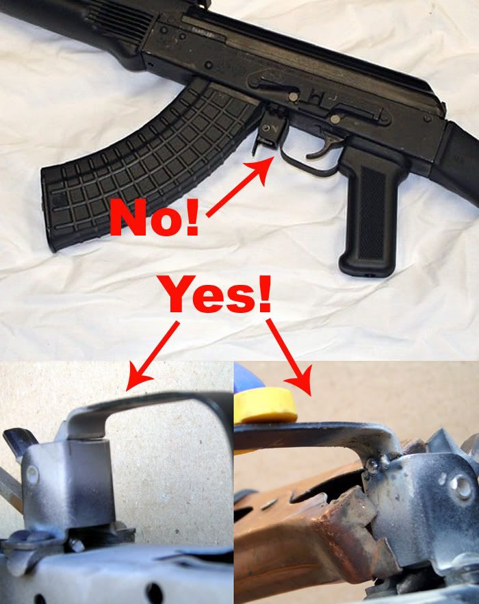

You are doing it right. That little lug will where out over time. They will sell easily for that price. I think everyone else will be in the 800's. I dont know how you will make much of a profit at 700. Lancaster's will be in the mid 800's. They are doing the same thing. They are building mine now. I will post when its finished.
This is constructive criticism intended to help you make a product that will compare well against other similar products already available.
First of all, the tuck-n-roll trigger guard is a deal-breaker in my opinion... It screams "I don't want to take the time to do this right so I'll just tuck this little thing under here and hope nobody notices". :goof:
Since you've already got the tig torch out, just take the extra 20 minutes and do the trigger guard right. Yes it takes more time, but it's no more expensive because you just reuse the Saiga trigger guard hoop. Bamaak (a builder here) has proven that skillful deployment of this method is virtually indistinguishable from a riveted trigger guard.
Also, try to find dimpled Saigas. With as much talk as the 'dimpled Saiga' subject gets, that could be a barrier to sales also (for those customers who are aware of this little detail).
The 'tuck-n-roll trigger guard" is just fine. It is a 'no load' part and the vast majority of folk will never look twice at it.

I'm not talking about the bullet guide, I'm talking about the front trunnion that just got zapped with the heat of a welder. The trunnion is not extremely thick at the point where the bullet guide would be welded, so it would be possible to blow through that area if you use too much heat. Also if that trunnion is heat treated or tempered, heat from the welding process can affect that. I doubt this is a worry though since I don't think the trunnion is heat set in any way. I think it's just work-hardened as a result of forging. I don't know for sure though I'm kinda guessing here, and my guess is that welding is safe and definitely quick compared to all other methods. The only danger is if it falls out. It's not likely, but it is possible that a dislodged bullet guide could cause a fire-out-of-battery and a kaboom.
You and I will have to disagree on the tuck-n-roll trigger guard. To me it sticks out like a sore thumb - this is how RedJacket did the Atlantic ones. Henderson will need to decide if it's worth the trouble to have this 'advantage' over RedJacket.

- Clip and weld the trigger guard. Our lead gunsmith used to be a fabricator for Indy and NASCAR teams (he was injured and can no longer work in that industry) and can weld anything. His welding skills are amazing and will not have a problem with making those trigger guards looking factory in a brief amount of time.
