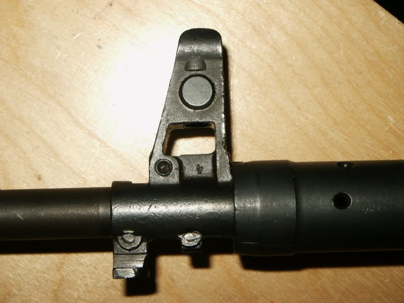

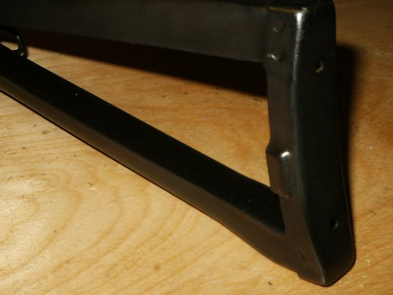

I was looking over my kit that I purchased from ORF back in early June and overall, it's a very nice kit. Bore is very shiny; all numbers match, I have the smooth butt/non-rolled edge buttstock and the Russian-style double rivet bullet guide and it looks like it would make a nice looking rifle.
When I looked over my front sight, however, it looked like this:
Are these machining/casting marks?
Also, were these kits arsenal refinished before they were cut up, or were they cut up as they were?

Looks like someone was using the front sight post as a latter :lol:
That's just a rifle with character! Good canidate to be built into a 'battle field pick-up' .... :wink:
you could prolly clean those marks up with a file. looks like someone was using it as a hammer :lol:

As has been said, those are impact marks made by an end user.
Build it as a battlefield pickup and make up a good story . . .
Or? Just Dremmel the nicks out... coarse, then fine sanding drum & you won't even know they were there. I routinely use that trick on Roms with really ROUGH casting marks.
Those marks look like the ones on my first barrel replacement rifle. I hammered on the front sight to get it to seat, and those marks were the result. In subsequent builds I put a piece od steel over the parts I want to hammer on.

Your rifle looks like it was hammered on at some point. The marks do not look like casting marks.
In that last picture it looks like the magazine lug has also been battered and the pins for the FSB look funky.
I think someone without proper tools has hammered the FSB onto your kit's barrel.
