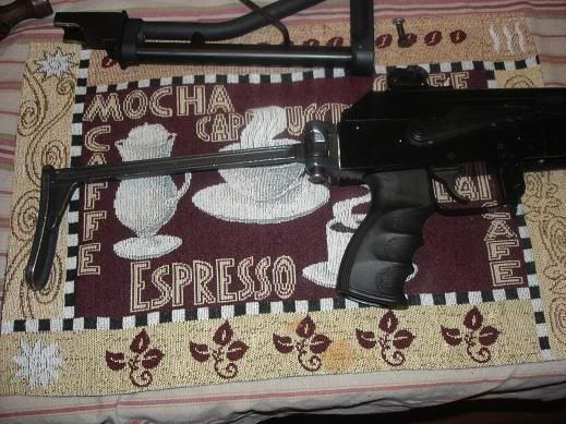

Im built a rear trinion block and will use this set up on my can gun.
Just used the sbr ,because its the only one that I own with the tang cut off for now. going with a Amd lower with a rail installed and a bulgy 24mm FSB moved back to 16.3" to the end. smooth non vented gas tube.

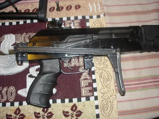

I built it out of plate. Ill be tig'n the thing to the trinon (where the tang was cut off) and 2 pug welds on the bottom. welded a nut on the inside. Ill put 2 small roll pin in the thing to keep it from twisting. It feels good and I think I have enuff down angle on it.

Can you work the safety, folded?
I was wondering the same thing. It looks like there will be enough room, but I haven't mocked mine up yet. Curious.

Yes you have a lot more room than with a underfolder. Its about the same room as a crutch stock.
Look at your CZ stock there is a little demple on the side of the buttstock. If put on right it lines up perfect with the bottom of the AK reciever. I posted pics. of mine finished.

here a couple of pics of my cur 2, 74 has no recoil so it comfy for me to shoot and stock stands out enough to operate safety

I used a Polish bottom folder trunnion. I located and drilled out a 7/16" hole on the rear surface, and used a nut on the inside. You also need to mill a small slot on the rear top of the trunnion for the lug on the stock plate. Once it was all together, I had the 7/16" nut MIGed onto the trunnion. This unitized the whole thing. It took a bit of machining to cut down the new 7/16" flat head socket cap screw to fit the stock plate, as the original is far from a standard bolt.
Since that pic was taken, I have adjusted the angle some. The pic shows the standard AK/VZ mating angle. I adjusted it so the stock closes a little higher on the receiver. I also modded the VZ stock so it would pull open without pushing the button, but will still stay folded under the latch spring tension.
I would have liked to use a Yugo trunnion, but the rear angle is too extreme, and they are too narrow to fit a 1mm receiver.
I think this stock is better than an underfolder, a Romanian/EG/Maadi/Tantal style stock or the AMD65 stock for shooting, but probably not as comfortable as the Soviet style triangle folders. Even with a 7.62 it is comfortable to shoot.
