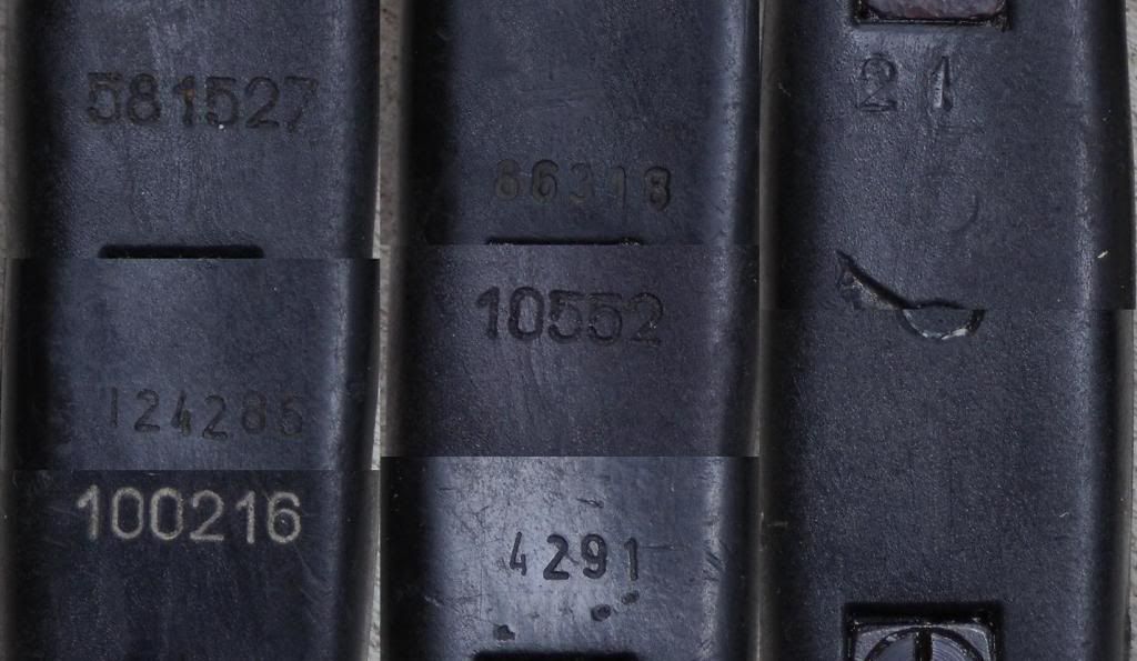

One thing first off. Early Yugo parts are marked with a part #. Many parts on an m64 are marked with a 4 digit number (many begin with a “3”). Milled m70’s lack these numbers except for the grenade sight and pistol grip. Stamped m70’s only have a numbered pistol grip. I use this system to identify early made parts.

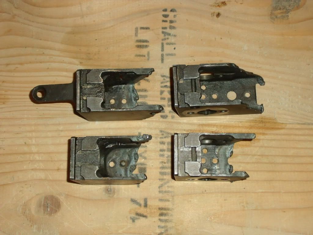

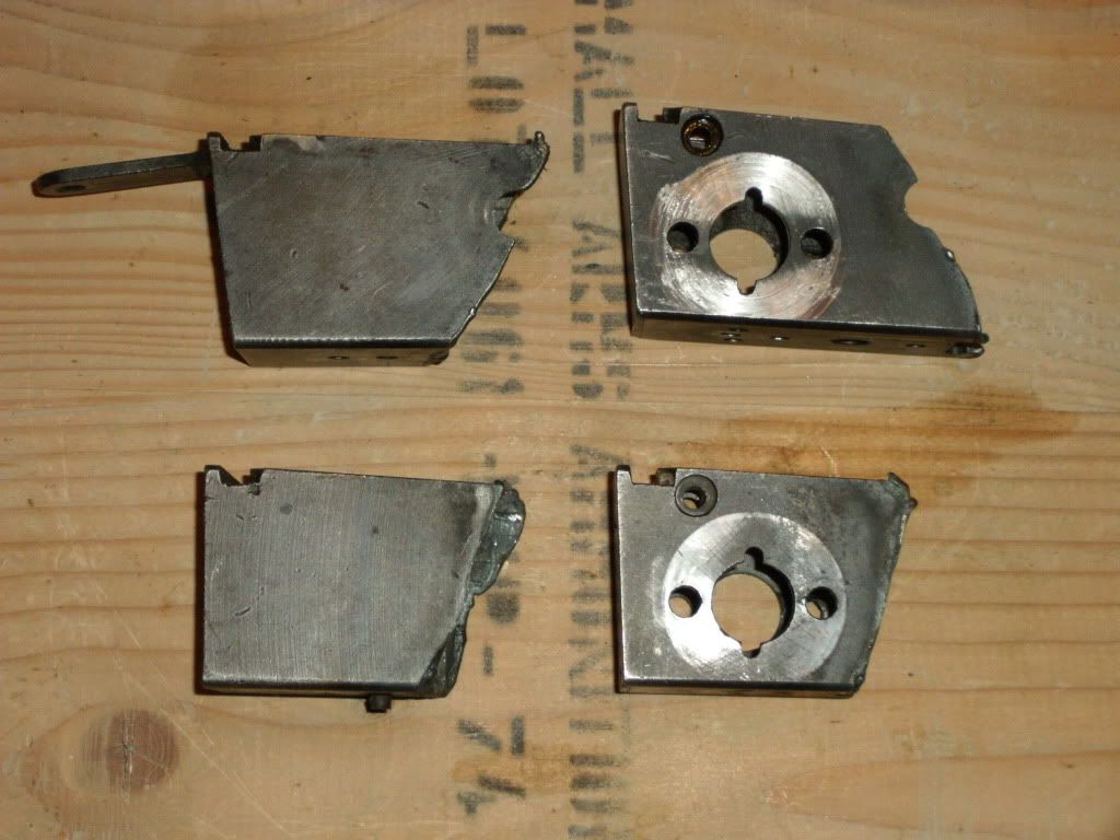

3. Gas blocks
GB’s from milled rifles have s cut out where the sight slides up and down and no vent holes at the rear of the block. GB’s from stamped rifles have no trench—just a dimple on both sides of travel and 2 vent holes on each side
4. Gas Tubes
Milled rifles have 3 vent holes on both sides of the gas tube (for use with the milled GB above). Stamped rifles use a gas tube without vent holes--they vent excess gas through the GB instead)

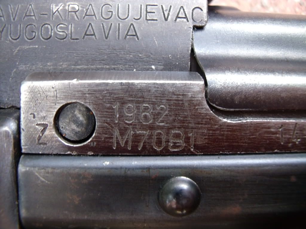

6. Trunnion Markings
There was a switch somewhere in which the models had periods between the letters and numbers. Early models had no periods (M70B1); later models added it (M.70.B1). Finally, I realize that they dropped the periods and began spacing everything out (M 70 AB2). Thanks to INFANTRY for the last picture.

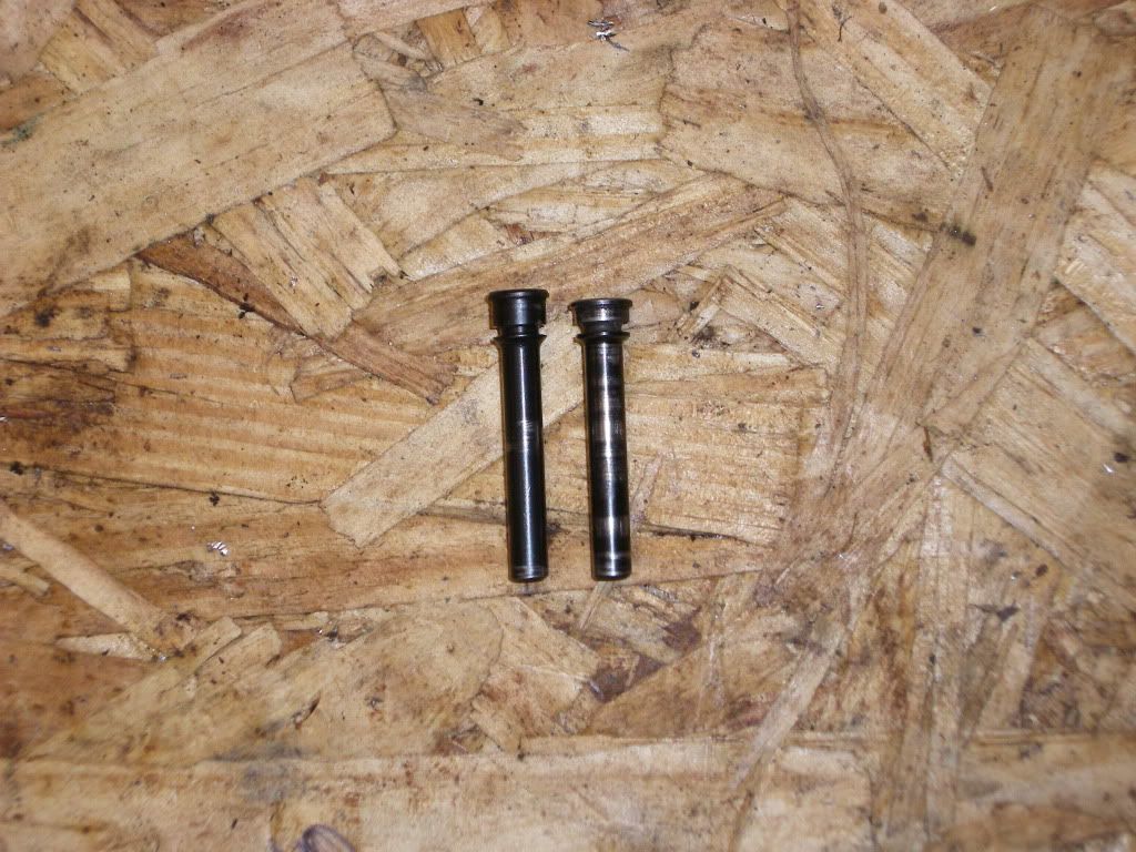

11. Axis pins
There are 2 versions of the axis pins. The first comes is used on the bulged area of the M64 receiver. This is the hammer pin and sear pin. It is longer to compensate for the extra material on the bulge. The shorter pin is used for the trigger pin on the m64 and all 3 pins on the rest of the milled and stamped rifles.

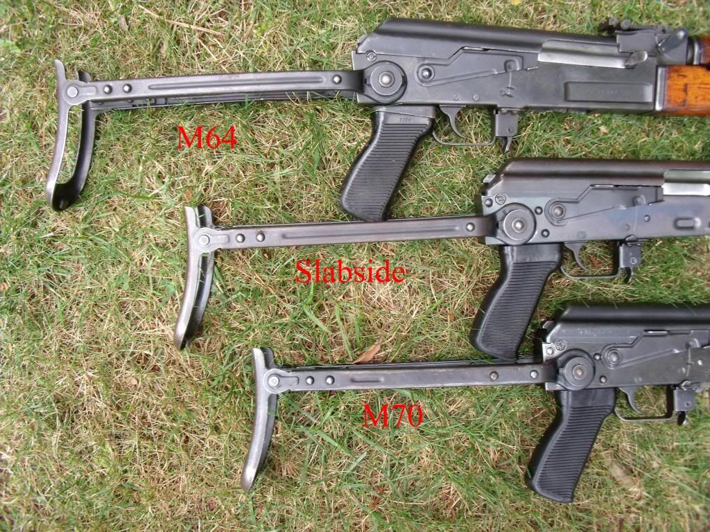

14. Underfold stocks
Early stocks (milled rifles) have 3 rivets on each side and a small clearance cut for the selector lever. Stocks from slabside receivers have 3 rivets and a slightly larger clearance cut for the selector lever. Later stocks (M70AB2) have 4 rivets on each side with more reinforcement and a larger clearance cut for the selector lever.

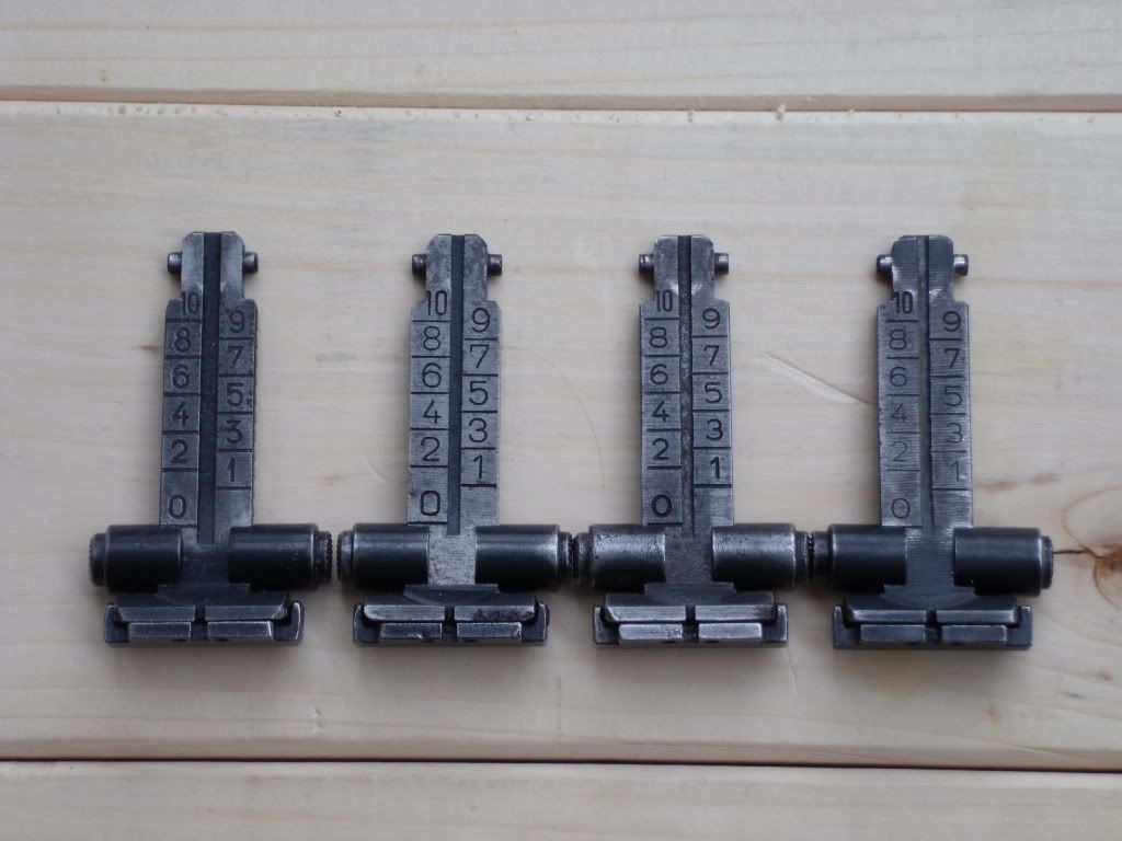

15. Sight leafs
No real explanation here. This just shows different fonts of the numbers.

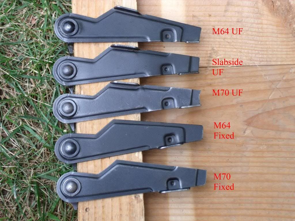

19. Selector levers
M64 UF levers have a small bottom small tab, levers from slabside rifles have a medium tab, while M70 have a large bottom tab. This difference is because of the different stock designs. Early stocks have a small clearance cut for the selector lever, while later stocks have a larger clearance cut allowing for the tabs on the selector to be longer. M64 and M70 levers are similar with the difference being the early levers having a straight stamping at the top while the later ones have a bulge at the top of the lever. This is also true for the UF selectors.

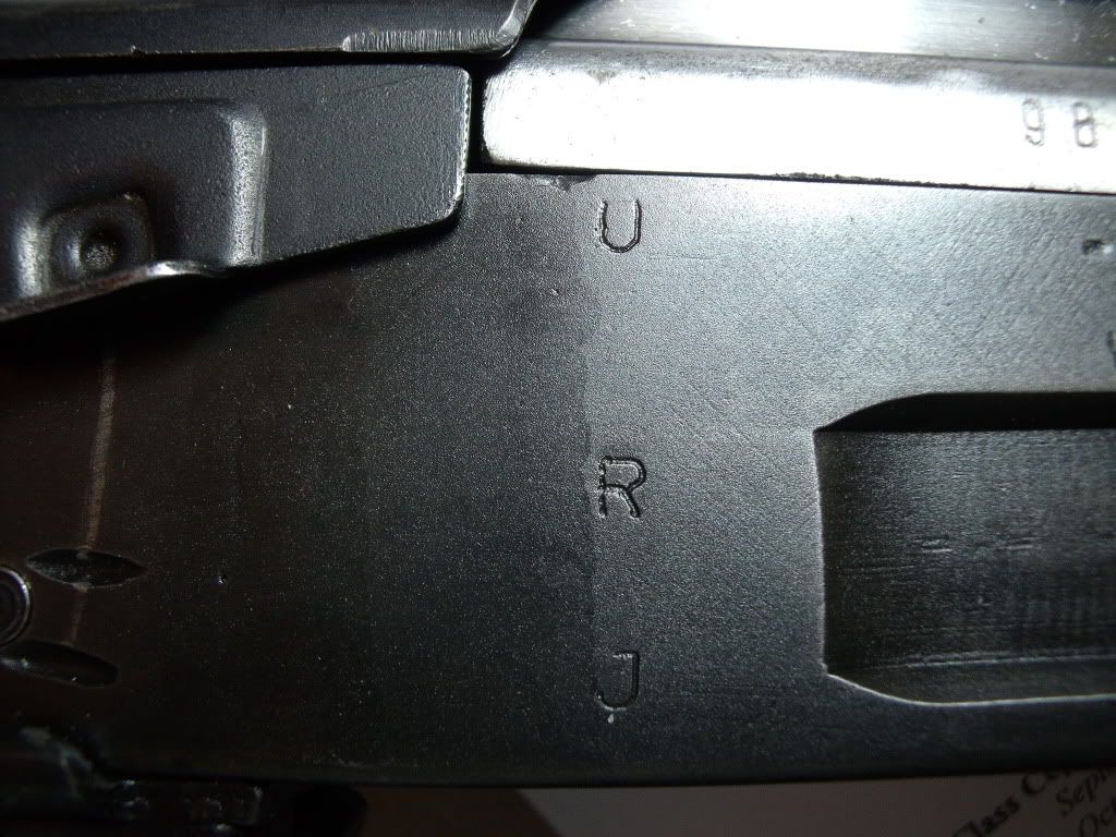

20. Selector markings
Some appear to be stamped, while others are engraved. There are small differences in the “J” and “R.” Thanks to INFANTRY for the last picture.

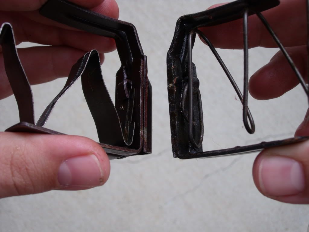

22. Bayonets
There are variations here in the color of the hanger (beige to dark brown), color of the wrist straps (very light green to very dark green), weld on the back of the wire cutter, size of the drain holes, finish of the scabbard (gloss to matte), shape of the handle, and serial number (both # of digits and size). I have one frog that attaches with a snap instead of the brass peg. I have only seen one of these. It came with a Yugo bayonet covered in cosmoline, so I believe it is genuine. I have bayonets with no serial number, 2, 4, 5, or 6 digits.

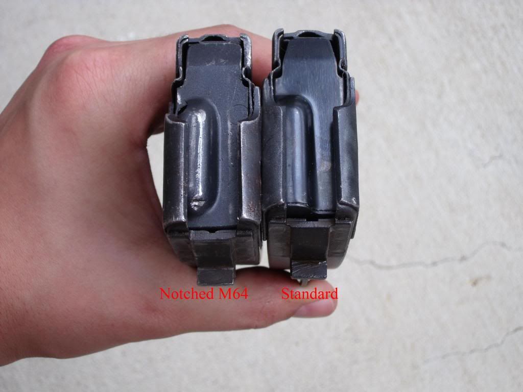

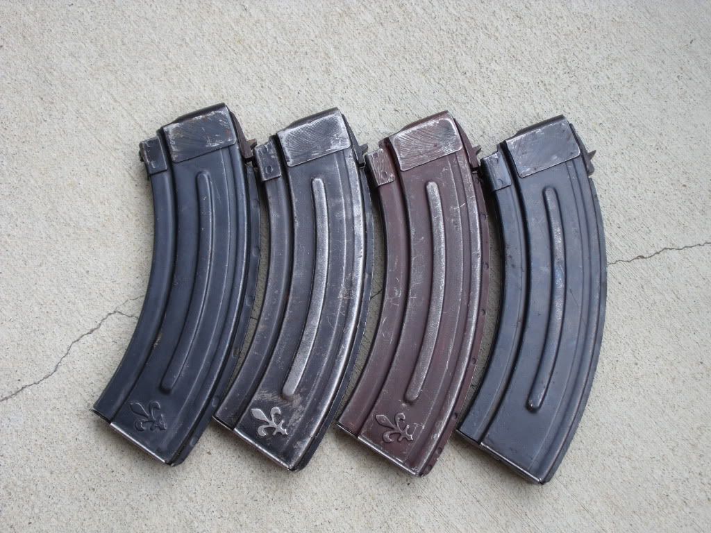

24. Magazines
It is my opinion that the matte magazine appeared first. Most of the notched versions I have seen are this way. Of course, notched magazines are for the m64 as they actuate the bolt hold open lever that was removed from many of these rifles. This m64 notched magazine has the 4 digit part numbers on it proving that all the parts are original to this magazine. So, I believe the order is as follows: m64 notched, matte blue, polished blue. The matte magazine typically has a 2 digit number stamped on the right side, at the top of the spine. Some also have a small “TK” in a box at the bottom. There is a version with the triangle witness hole that has several other differences. The follower is slightly different, the lug on the back is different, the stamping at the bottom of the mag is different, and the finish is slightly different. I have no good explanation for where/when these were manufactured.
25. Bosnian Mags
This is just for fun as it’s not really a Zastava variation. In my experience I have seen 2 variations of the Fleur-de-lis magazine. One has a large witness hole and the other has a small witness hole. Furthermore, some magazines have a unique flat spring while others have a coiled spring. This coiled spring is unlike standard springs. It is not as wide front to back and is much stronger. It can be tough to put one of these mags back together. Note the unique spring/follower attachment. Also, notice how some of these mags can be almost pink/purple in color. The follower in this mag shows the same coloration.
