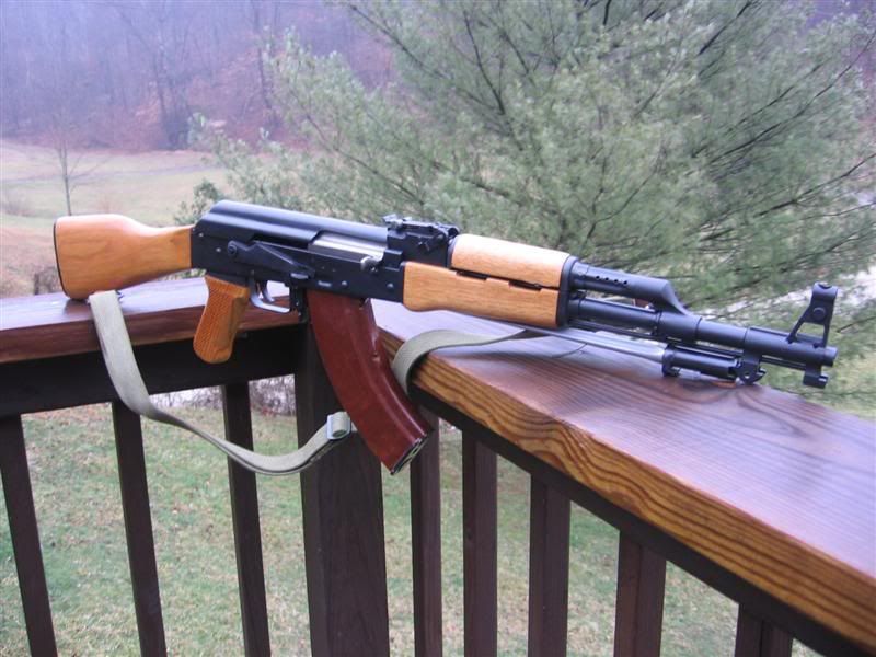

I turned mine into an RPK style rifle. Threw on a Romanian stock set, replaced the pistol grip, piston and FCG and flash hider for US versions and then put on a AES-10B take-off bipod on it, which worked out well as it is short enought to suit the shorter NHM-91 barrel (which is shorter than a true RPK barrel).

Those pics have got me warming to the idea of just keeping it as an RPK clone.

doubleclaw you can install standard RPK furniture on the rifle. I have Russian laminate on the one above. The only modification needed is the the lower handguard. The retaining plates for real RPKs are much larger than the NHM models. NHM models use standard AK47/AKM retainer plates.
To fit the RPK handguard to the NHM retainer plate was easy, I just used a simple box cutting knife (essentially an exacto blade) to fit the wood.
