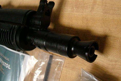

Where can I find a Bulgarian muzzle brake like pictured below?

Are you putting this on a Krink, or a 105 type of rifle?
I want to SBR a SLR107-61 7.62x39. Have a link to where I can find one?
552 Posts
Give Chris Butler at AK-USA a call. (239) 334-4231. At one point he was making the correct booster for the AK-105 That was timed for the bulgy FS/GB. I think he might of also made some in 7.62X39 Not original bulgy, but you cant tell the difference. His brakes and boosters are a faithful representation of the original, and top notch quality.
+1 I had an AK103 clone done by him, and the brake was top notch.

Is there any issue with SBRing a SLR107-61, by cutting the barrel down to the correct length for the muzzle brake? Was looking at getting Piece of History to do the job.
552 Posts
Pretty straight forward job if you are comfortable cutting and recrowning a barrel. Alot of guys dont even pull the FS/GB to do it. I dont have any experience with piece of history, but general consensus around here is that they are a great group of guys and are also top notch. I would not have any qualms about sending an Ak to them.
