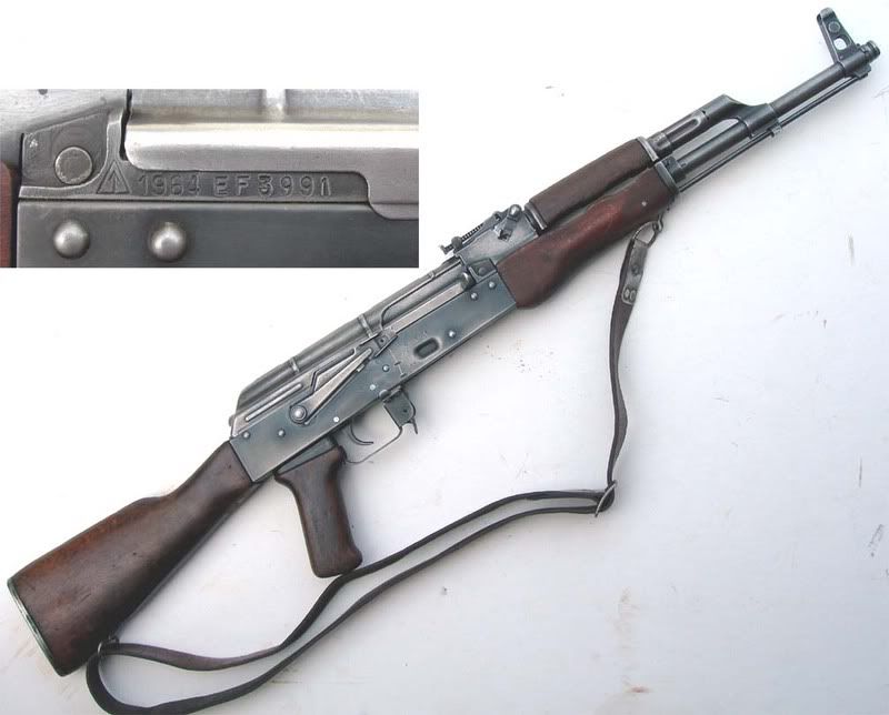

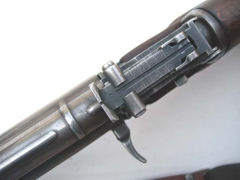

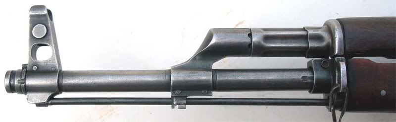

Rob: Here is my '64. It is original finish except for the receiver (and front trunnion). What little is left is black looking, but it does look like a dip blue (slight blue tint is from the open shade photo). Funiture was original with the kit except the lower forearm which was a laminated pistol grip type, age and condition were close to that of the rifle.
By dip blue, you mean something similar to old Hungarian/Polish milled stuff, or something else ?
Beautiful rifle cmutka!

no doubt! Fabulous!
Thank you gentlemen. By dip blued I mean it was blued with no polishing either before or after the blueing. The NDS receiver was wire wheeled, then cold blued, and finally worked on with a very well used abrasive pad and oil.

cmutka - I have a 1965 kit that looks just like that. Just started it night before last. What did you use on the wood? It looks like it was hand rubbed by a thousand hands. So dark and oily. Looks incredible. Like it has been being used constantly since 1966. Also what front lower did you use?
I like that german lower on the last one too. Such a fat bulge. (I sound like a pornstar! Jeez!) Nice looking gun though.
The stock, pistol grip, and upper are as they came in the kit except for wiping off the oil and dirt. The lower is from an SAR1 (since the kit came with a pistol grip lower), stripped the finish, stained it with multiple coats of Old English scratch cover for dark woods (something I had on the bench and usually use on M1 or other similar stocks), and several coats of gun oil. Got tired of rubbing it, so that is where the process stopped.

I am not near my 1964 kit, but I agree that it looked dip blued. Gives the blue a darker color vs. the shiny blue on Chinese and some Yugo AKs.
Is that the original pistol grip? If not, what country is it? I can't say enough about this rifle. I have two similar kits that I am starting on. But my wood does not look like this. Of course I will have to replace the donkey dong. And love the EG lower you put on. But the pistol grip I got is the funky bakelite crap looking ones. But also my overall wood color looks more red than that deep oily brown. I'll have to work with some of that old english on the donkey dong to test and see what i can get out of the other wood. I don't remember my kits having the ribbed top cover either. But mine are 65' and 73'.
Anyway. Your rifle is amazing. When I envisioned doing these kits I had your rifle in my head. It really looks amazing.
