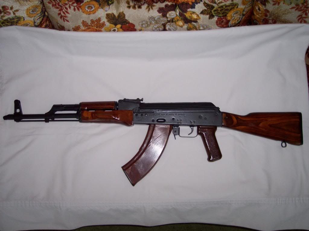

I just put my AKM together that had come back from Piece of History for some work that had been done to it. It is an Izhmash conversion that Red Jacket did originally if you could call it that. They did a horrendous job on the conversion, sloppy and cheap but after $580 Mario fixed it up right. After seeing the great job Mario did on my AKM I'm never using anyone else for my AK jobs. He is the man.:)

Very nice! Mario always does fantastic work, and seeing his rifles are like seeing masterpieces in the gunsmithing world. Mario has my Polish Tantal right now for a complete rebuild. It definitely isn't a cheap venture...tack another $100 on for what I'm having him do to the Tantal.

Mario had to replace the hole trigger guard magazine release assembly as Red Jacket just used the cut Saiga trigger guard. Filled in the slot where the blot hold open lever was by the trigger, fix the rear sight base as the sight was wobbly from Red Jacket. Remove side scope rail and fill in holes smooth, correct selector dimples and markings on receiver. He had to fix a few extra little tid bits on the barrel and receiver. Refinish entire gun and parts. I'm very happy with his work. Yeah, wish I had taken a few pre pics but didn't.
