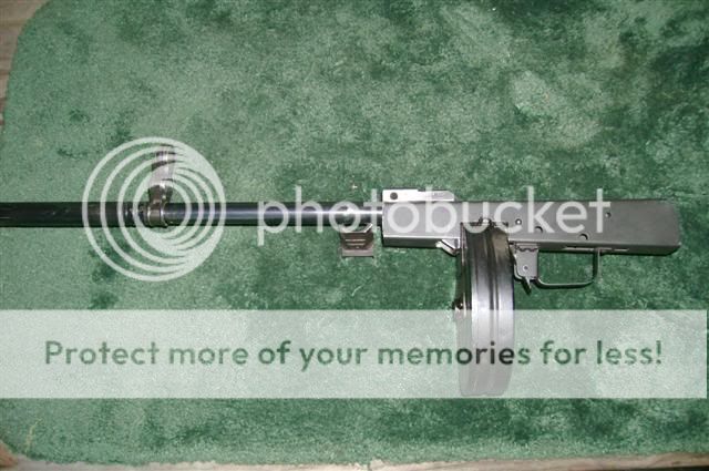

well im starting my first calibur conversion a 2xtm. i picked up a suomi kit for the donor. i got an airsoft xm177 flash hider for barrel extension (perfect fit). i would like a 19 mm trunnion chinese or one of 'tt' if someone has one they decided not to use. it would save me the barrel sleeving. i would also like input from anyone
who has built one. im using a ertd 1.6 receiver . i plan on using a galil gastube in conjuction with the H&K triple frame. i'm also going to use the EOD tok bcg
here is a pic of progress so far. . i got a long way to go yet but anticipation is half the fun of the build.

i managed to pick up a couple of the Lichtenburg magwell's. curtis has flats for these but i figured and i was right the 1.6 receiver eliminates the gap betweeen the magwell and the lower rails. once you grind the mag stabilzer's flat on the lower rails the Lichtenburg mw is a snug fit. also the 4.350 cut on the Lichtenburg tutorial turned out to be 4.300 on my magwell opening .good thing i practiced on a old flat that i had previously bent up. he has a disclaimer
calling it a 80% mag due to some tweaking involved .this one for sure will be a challenge . but a guy with your skills should be able to pull it off easier than me. i have an extra magwell if you need a reverse engineering subject. i have no drafting skills or i would put it to paper for you.

well i picked up some more parts and worked on the build some more. i dremeled some slots for my galil gas tube in the trunnion. i got my barrel sleeved and hg retainer set. the hg retainer consisted of the bayo lug part of an ar15 fsb milled flat and drill and tapped for screw. also adjusted the mag height. i done some trials with a 74 bolt it seems feed the round and eject good. i hope that doesnt change with the eod bolt. i still need to study on the mag catch some and what to do with the big gap that will be on right side from barrel being pushed so far back . i'm totally open for imput on this.
anyone?

Discussion Starter · #13 ·
turbothis said:
the drum looks mighty low.
its just a mock up .when everything is fastened and mag catch is built it will be tight. i fit it to just keep the bolt from hitting back of drum. but im not going to commit until i get the bolt from eod.

Discussion Starter · #15 ·
turbothis said:
that is the only thing i hate about the drum mag request on these types of projects. the drum eats off a lot of the receiver and makes it kinda flimsy.
that was part of my reasoning for using the 1.6mm but with the MW sitting up againest the lower rails and between the mag stabilizers it should be plenty strong once it welded in.

Maybe you can get some ideas from these:
Here's what AZ ****** did with his. He did'nt set the barrel back but used a bullet guide and lengthened the feedlips on some stick mags. He welded a small shroud to cover the gap on the right side of the barrel.
Uploaded with ImageShack.us
Looks like he added an extension to the AK mag catch
