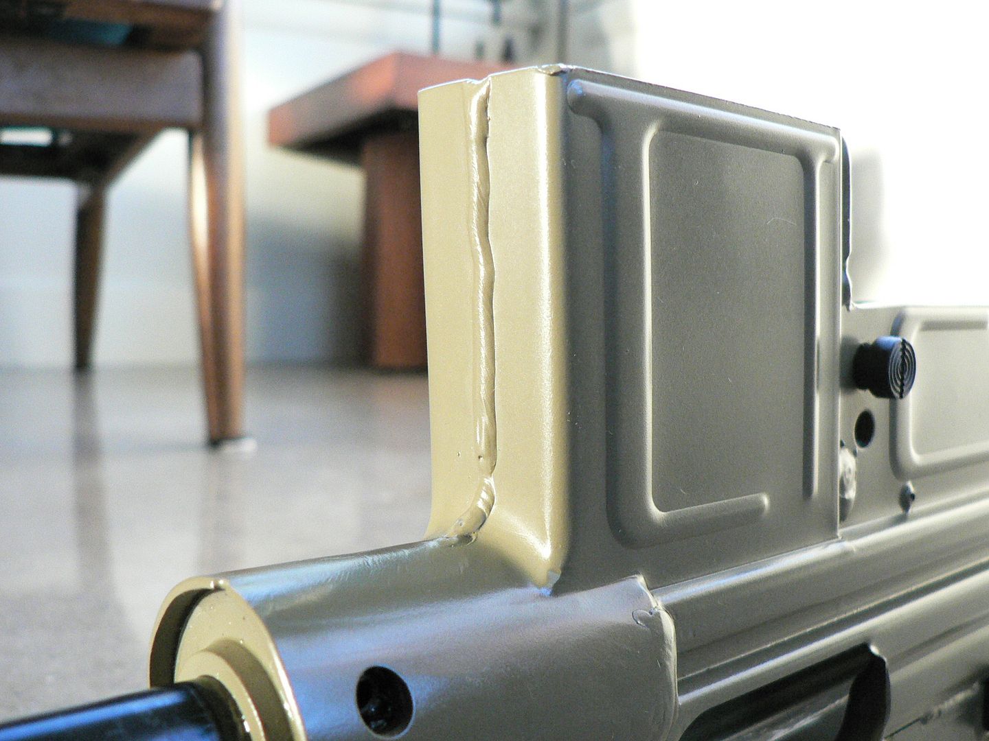

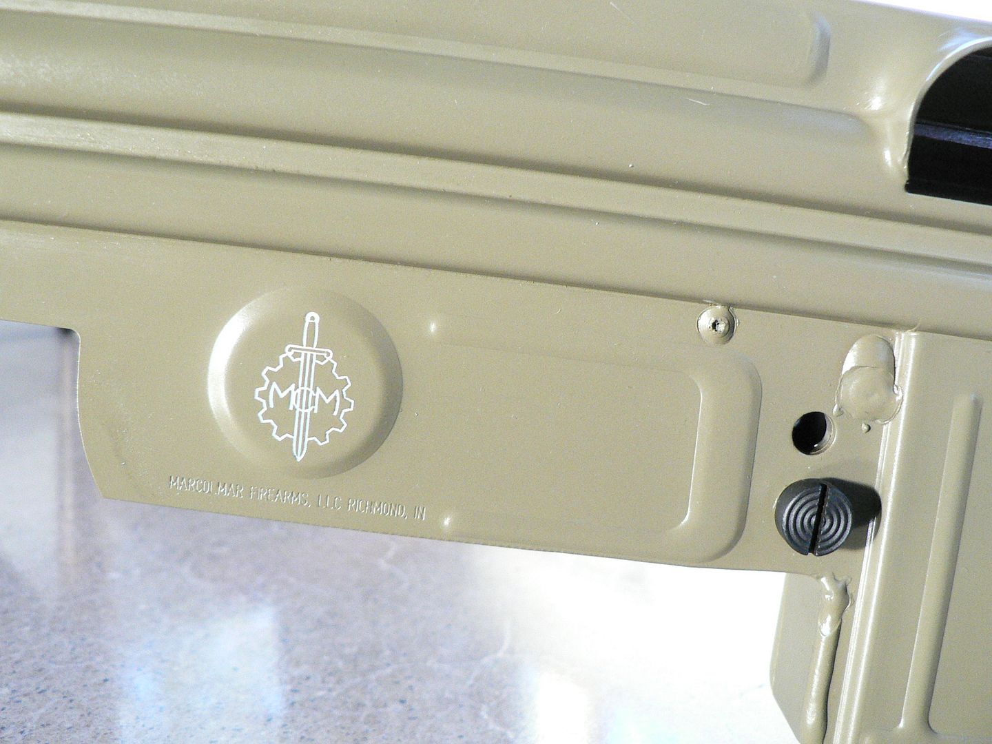

    Let me warn you right off the line....this is going to be a long photo essay. And bear with me in this first post because a fair amount of commentary is needed before we get to the gun porn. This write-up is really intended to be a detailed look at the recently released Cetme L by MarColMAr Firearms (MCM). In truth, this rifle is more of a reproduction than a semi-auto rebuild of the Spanish Cetme L from a parts kit. I say that because much of the rifle is newly manufactured including, but not limited to, the receiver, barrel, furniture, trigger pack, magazine and a few other bits (we'll get to the full list of US made parts in a bit). Now, that's not a put down of this offering in any way. In fact, according to the owner of MarColMar, Dave Bane, this new rifle is actually superior to the original because of various upgrades including modern polymer furniture, a hammer forged barrel, better quality springs, and a host of other small changes intended to make the design more robust and reliable. Given MarColMar's track record, I tend to take Mr. Bane's word for it. I'll find out though once I get it to the range for testing and I will update this essay at that time.
    Ideally, I would have an original rifle to compare this one to but, unless one of you guys has one lying around I can get my grubby paws on, we'll have to settle for one of the Hill & Mac Gunworks (HMG) specimens released back in late 2016. Unfortunately, only 100 of those were made by HMG, although for a while they did also offer a "build from your kit" service and a "builder's kit" if you wanted to do it yourself. So, while they only officially produced 100, there is a fair, albeit unknown, number more than that floating around. These rifles were essentially a kit gun built from very good condition imported parts sets using only the minimum number of required US parts. As such, they looked fairly used right out of the box with scratched up furniture and worn finish on many of the parts. For many, myself included, that was OK though because you knew you were getting something as close as possible to the original form. Besides, a little patina added to the looks if you ask me. The best part of all is that, despite the slightly used appearance, the HMG rifle is very accurate (I get more accuracy with mine than I do my HK93) and generally very reliable. Mine is over 99% reliable so long as I use GI magazines with strong springs. However, old worn magazine springs is another matter causing all kinds of weird misfeeds or even no feeds when the magazine is near empty. But Brownell's will fix you right up with new springs cheap and your AMG (it's painted green so it's an Army Man Gun) will run like a top again; at least mine does.
    Now, simply putting a parts kit back together to make a legal functioning rifle was not good enough for MarColMar. They have built a reputation over the years for crafting what could essentially pass for a new firearm out of a decades old retired and torch cut pile of surplus parts. They only select the best parts kits its to begin with. Then they carefully modify the design to make it an ATF compliant semi-auto while preserving the look and feel of the original. This includes in-depth testing and ongoing development until they are satisfied that the end product will look, feel and function at least as well as the original was intended to. While sorting through the kits and developing the prototypes, any components which do not meet their aesthetic or functional standards are reproduced using the best possible materials so that they are as good or better than original factory parts. Only once they have everything finalized and sourced do they move on to production. MCM feels it's far better to delay a release date in order to work all the bugs out of design and logistics than it is to release a flawed product on time. Production itself is done using the most modern methods (including a welding robot on the Cetme L) and materials. The end result is a firearm that looks and functions as good or better than the originals did decades ago. According to Dave Bane, that's always been their standard way of doing things and that's the standard they've held their new Cetme L to as well.
    So, did MarColMar succeed? Well....I don't fully know.....yet; but I will once I get some rounds through it. I will say though, it LOOKS very, very nice; not perfect mind you, but it's pretty darn close. So far, I have no regrets about how I spent my money. There are a few things to nit-pick and believe me, I will. But that's my self-appointed job, to show every little detail, both good and bad, so that you can make an informed decision about whether or not you want to spend your hard earned money on one. I will not be discussing price. You can easily look this rifle up in any search engine and find both MarColMar's website and any vendors selling them. As stated, my intention is to show you this rifle in detail so that you can make up your own mind about whether or not you wish to purchase one. Also, as stated, the HMG rifle is no longer in production or available from HMG. I include it here for comparison purposes only so that you can see the obvious difference between a rifle put together out of a parts set and one remanufactured to be as new.
    This pre-firing write-up will take some time and multiple posts to complete so keep checking back to see new material. I'll let you know when I'm done and I'll update with range reports once I get my wussy butt to the range.....I hate the cold and there's no revolution currently going on so I can be picky about weather. Let's get started shall we?

    Here, we see a comparison of the welds on the two rifles. To be specific, we are looking at the weld where the cocking handle meets the front of the receiver. The MCM is at the top:
    Notice that the HMG has a better weld here. Not only is the MCM weld aesthetically inferior, but it also shows an ugly void. I'm sure it's plenty strong but it is unsightly. In fact, it's the most unsightly weld on the entire rifle. While we are on the subject of welds, let me say that, in my opinion, the rifles are equal. In some places the HMG is better while in others the MCM is the winner. I'm not going to call out each and every detail but I am going to show the same areas on each rifle so that you can make up your own mind about who has done the better job. I will say that I think both exhibit sufficiently strong welds and I have no worries about failure on either rifle.

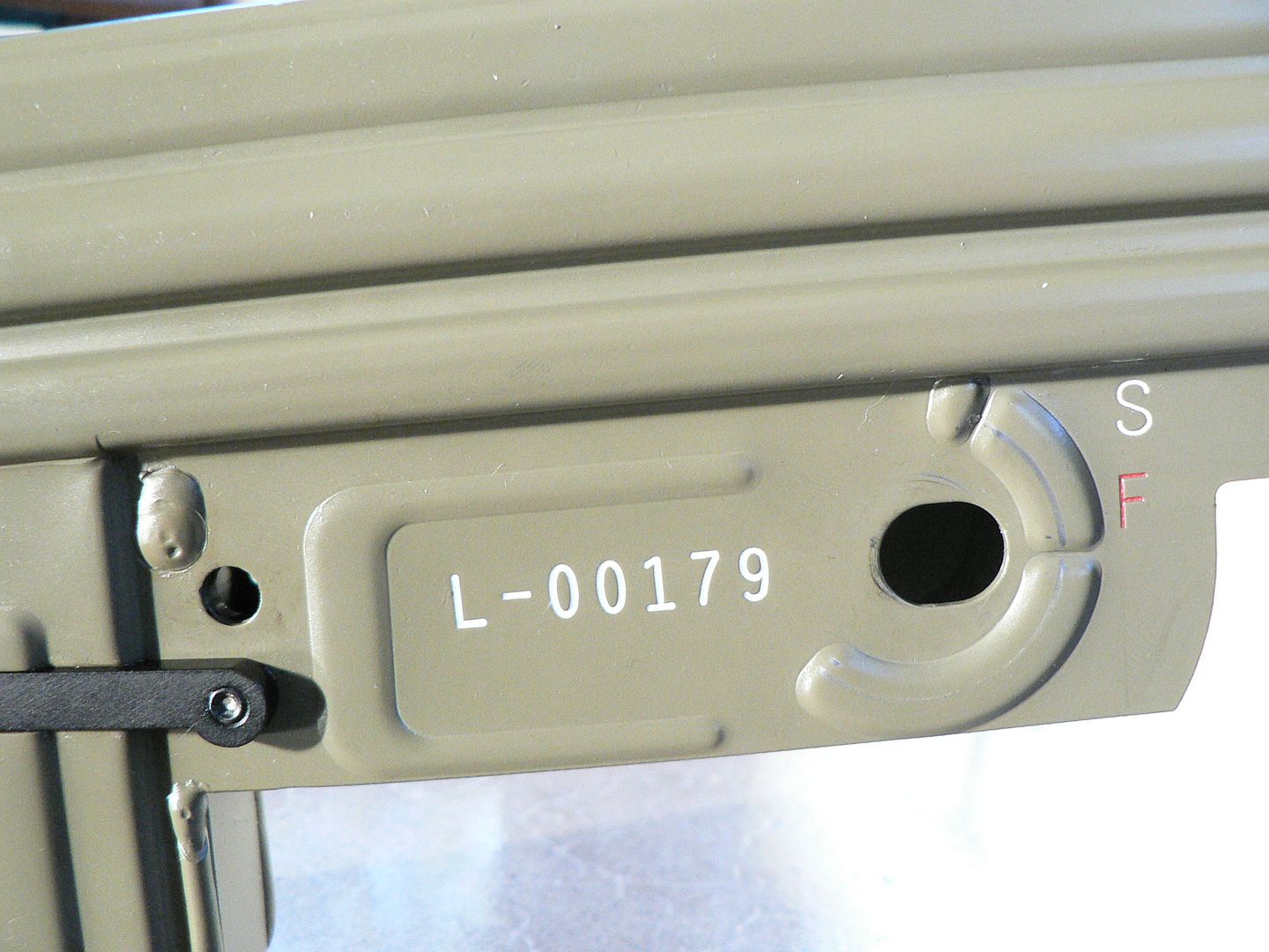

    Here we see the right side showing the manufacturer's marks:
    The HMG has crisp easy to read markings but I guess they were laser etched because they are so shallow. The problem is, they are so shallow you can't really fill them with paint. I only care about that because originals were filled in so, if you ask me, the reproduction should be too. MCM seems to understand that and their receiver shows nice deep roll marks well filled in with paint just as an original was. I also like that they didn't fill in the writing below their logo because that stamp wouldn't even be present on an original. I do prefer the looks of the spot weld near the takedown pin hole on the HMG over the arc weld on the MCM. Also, while all of the reinforcement ribs on both rifles are quite crisp and very well executed, the HMG stamping is ever so slightly more crisp throughout. The various ribs also differ slightly in detail between the rifles. I do not know which detailing is more accurate though I will figure it out once I find an original. But I assume the MCM is the more accurate since they had an original in hand while working up the dies.
    Serial number and selector markings:
    The HMG markings were not filled in when it was new. I did that but they are so shallow that it took me several tries to get even the marginal quality shown here. Fortunately, the pathetic paint job is not so obvious in hand because the letters are much smaller in the flesh. There is no such problem on the MCM. In fact, it's no problem at all since it came that way. Yay!

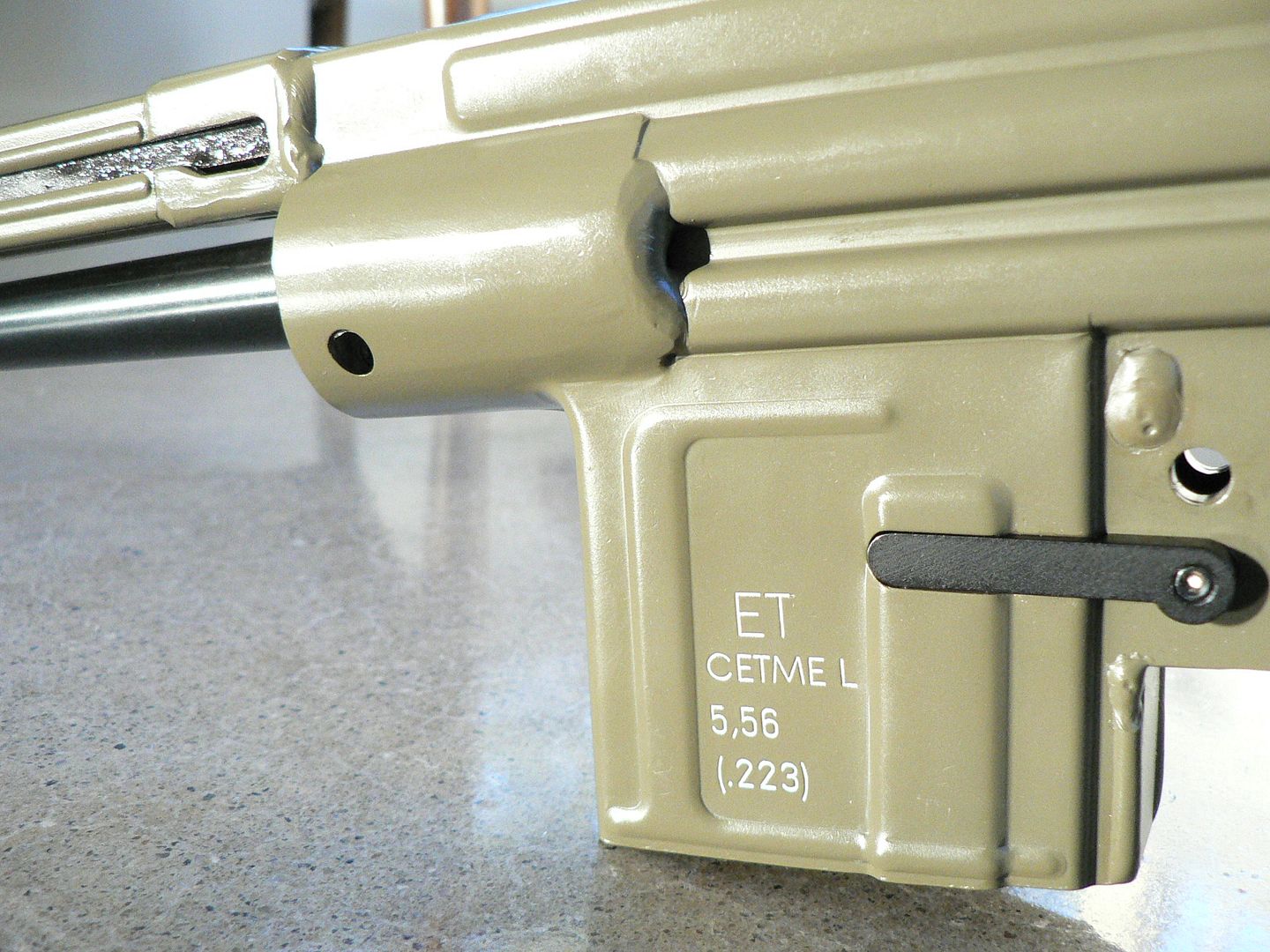

    Magazine well, left side:
    The MCM marking are again far superior to the HMG ones. MCM even stamped it "5,56" just as it should be.

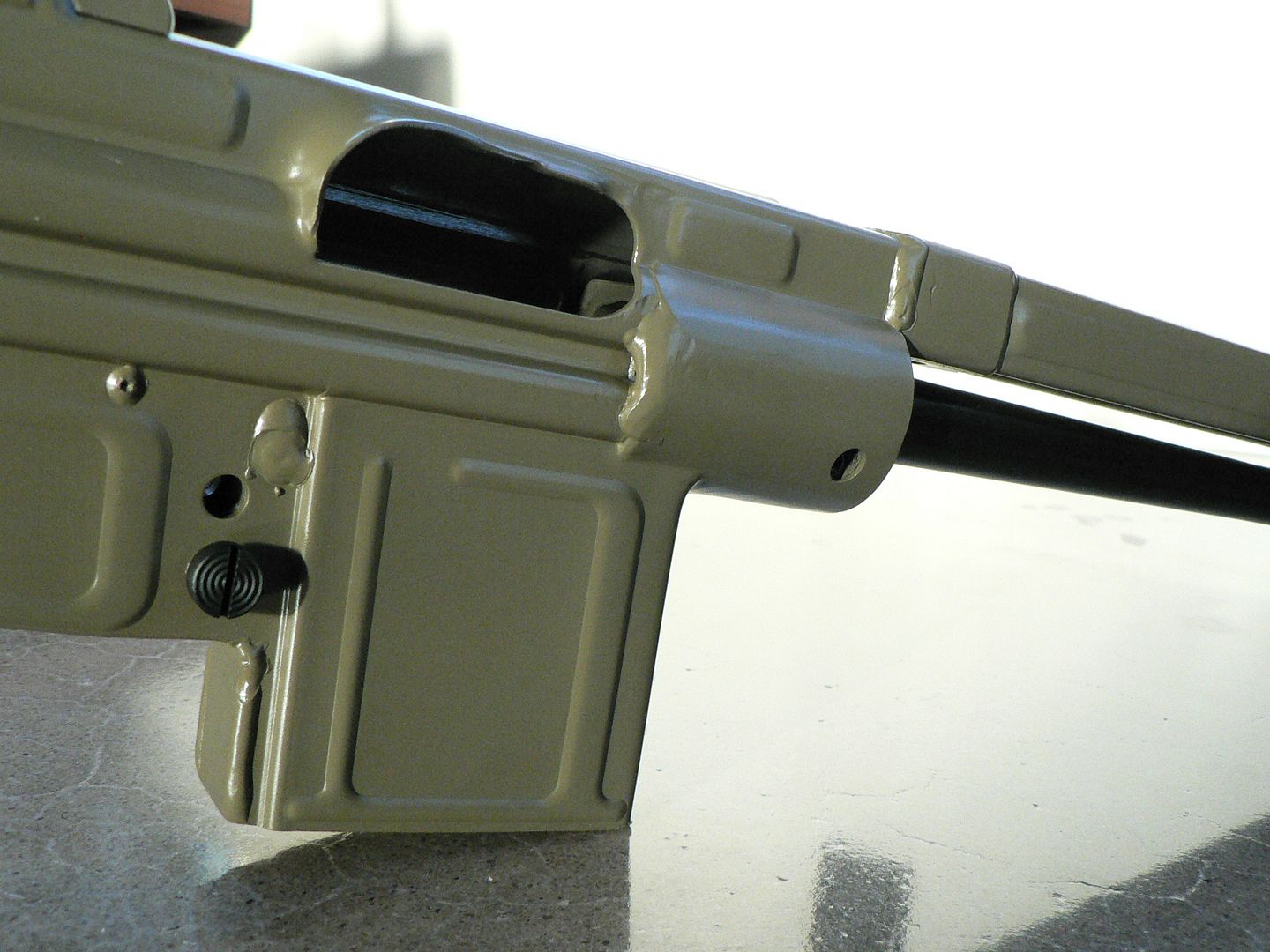

    While we are looking at this area, I want to point out some other things of interest. These two pictures are the best ones I have showing the fact that the HMG reinforcement ribs are more crisply stamped. Notice especially the upside down "L" shaped rib running in front of the script parallel to the front edge of the magazine well. On the HMG, the main "field" of the magazine well is perfectly flat until it reaches the edge of the rib. On the MCM, the field slightly curves up to the edge of the rib. This is accentuated (on purpose) by the glare . Still, this in no way diminishes the MCM work in my eyes. It's still extremely well done; I'm just nit picking again. Also notice the bottom of the rib that runs up to the magazine catch. The MCM has the proper rib on top of a rib detail present in all pictures of original rifles I have seen. This is completely absent on the HMG unit.
    There are significant differences in weld patterns/techniques too. It appears that HMG used spot welds on the side of the trunnion whereas MCM used an arc welder and then ground the welds flush. MCM also filled in the exposed area at the back of the trunnion where it seats against the guide rails while HMG did just the slightest tack weld at the top and bottom of this opening.
    Lastly, you can clearly see the barrel retaining pin hole on the MCM AMG. This detail is completely lacking on the HMG AMG. While it's true that the chances of ever having to fiddle with removing the barrel are pretty remote, it still should be there. That's the kind of goofy thing Century Arms would do.

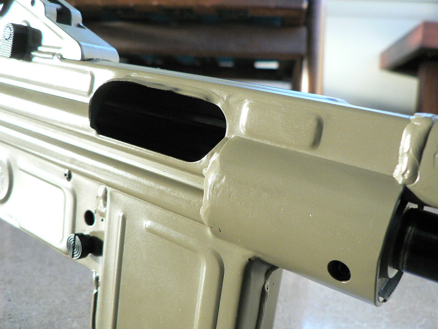

    Magazine well, right side:
    Here again, we see a big difference between the two with regards to the area where the trunnion seats against the front of the guide rails. HMG has placed only a tack weld at the top and bottom of the opening while MCM has filled almost the entire thing in. One of the biggest oversights HMG did was to exclude the flare around the top and rear of their ejection port. Why in the hex did they not put it on there? I'm not going to wade into speculation about why it was omitted but the fact is.....it ain't there. MCM put one on there though. Do you know why? I do. It's because there is supposed to be one, that's why.
    Here's another view of the flare on the MCM:
    It has a little waviness to it along the top edge. And, comparing it to the original rifle shown in the Forgotten Weapons video titled "CETME-L History & Disassembly", it might run forward a little farther than an original but hey, at least one is present. It looks fine to me.

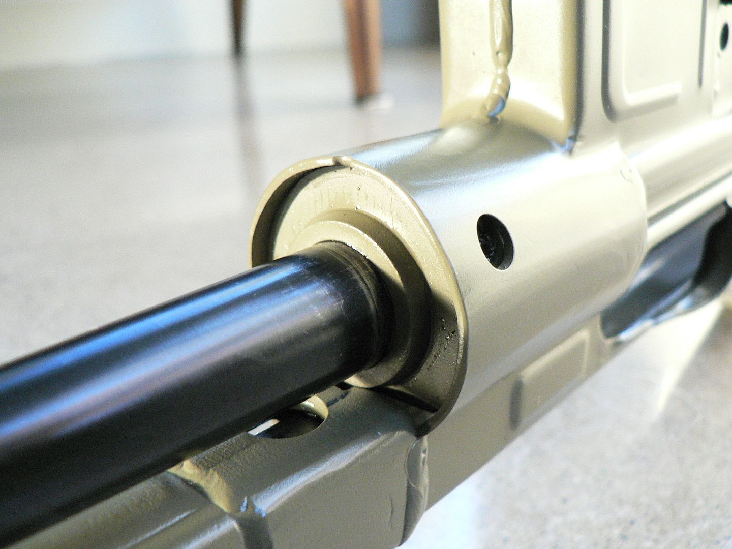

    Front of trunnion where the barrel plugs in:
    Note again....no exposed pin on the HMG. What the hell were those guys thinking??

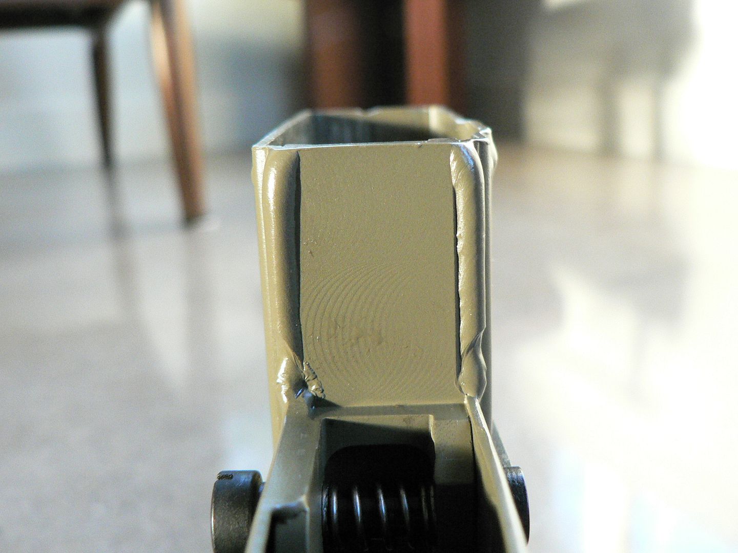

    Rear of magazine well:
    As explained earlier, this is a milled block welded into the receiver shell. So, three sides of the well are formed from stamping and the rear is a block. You can see the machining marks on the MCM. I like machining marks. They give a rifle more of an industrial, no nonsense look. It also reminds me of a late war German rifle......maybe something designed by Mauser......maybe something that operates in a very similar or even identical manner as the Cetme L. Are you listening here MarColMar? A guy can dream can't he??
